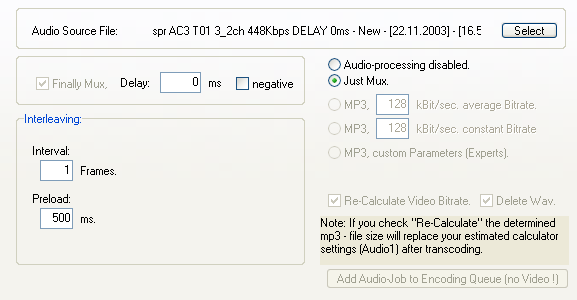

Then go to the audio1 tab, press Select and select your MP3 (or Ogg) file from Robot4rip (or AC3 file in case you want AC3 audio), and make sure Just Mux is selected.
All you have to do here is check Just Mux and you're all set. If you have a 2nd audio track now go to the audio2 tab and do the same.

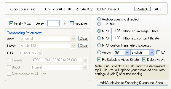

In case you didn't use Robot4Rip or Robot4Rip did not give you the desired MP3/OGG file, you'll only have an AC3 file that you first need to encode (if that's the case, prior in the guide I told you to make a mental note that you need to encode audio). You can select it as described above. The screen will look a bit different though:
All you should change is the bitrate, and the type of audio file (set it to MP3, xyz kBit/s average Bitrate for ABR audio, MP3, xyz kBit/s constant Bitrate for CBR, MP3, custom Parameter so that you can configure azid and lame parameters in the Transcoding Parameters section, or finally Vorbis. In case you select Vorbis, you can also set a language for the track (in the audio selection menu instead of a track number the language will show up), and check 5.1 if you want to retain 5.1 audio).
And, if you want to keep the AC3 audio, select Just Mux.

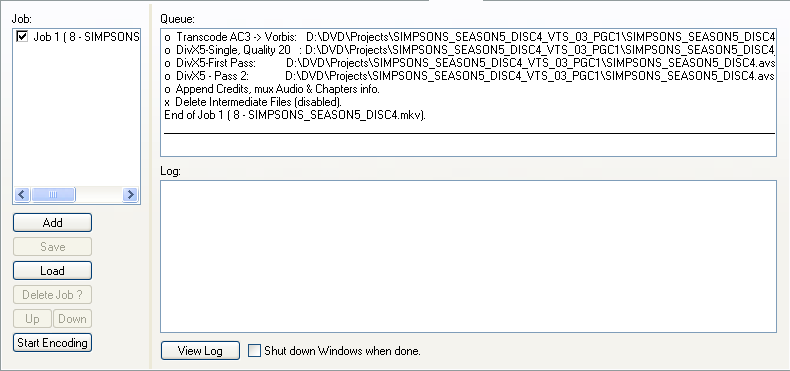

Just in case, let's have a look at the Encoder tab as well:
In the Job section, you'll see all your defined jobs. Pressing Add will get you back to the job definition window (the one you get to after pressing Save & Encode in the preview window) - personally I don't get the sense of that since you ought to go through the preview window where you can define important project parameters.
If you select a job from the list, you can press Save and write all the settings you have made to a file. That allows you to save a job, close Gordian Knot, and when you turn your computer back on, you can go back to this screen, press Load and load your job again and start encoding.
Selecting a job, you can also delete it by pressing Delete Job ?, using the Up and Down buttons you can move a job up and down the list, and Start Encoding will start the first job in the list.
In the Log section, you'll also see Gordian Knot's log. This might come in handy of something goes wrong.. the log should give you some hints regarding what exactly went wrong.
