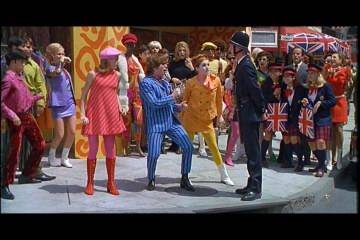

Now let's have a look at a real example: Austin Powers: International Man of Mystery, R1. As this is an NTSC disc the video stream has a resolution of 720x480 (PAL discs have 720x576.. but everything explained in this article also applies for these streams, but the resizing takes the vertical resolution 576 into account). This disc contains 2 versions of the movie: widescreen version and standard version. Standard (also called fullscreen on this disc) is the standard for a 4:3 TV, that is a picture that fills the whole screen, whereas widescreen in this case means 16:9. The expression widescreen should not be used in that way since there is 2 different widescreen variants: letterboxed widescreen and anamorphic widescreen, both of which will be illustrated a little farther down the line. After ripping you can load the VOBs from the widescreen side into DVD2AVI and you'll get an output which looks like the following:
This looks a bit strange doesn't it? Of course, it's 720x480 which gives an aspect ratio of 1:1.5 whereas the movie actually has an aspect ratio of 1:1.85.
When you press F5 for preview the statistic window will tell you that this is a 16:9 stream.

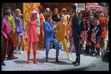

When you watch the movie in your software DVD player what you'll get is this:
This looks better, right? People are not longer squeezed and thin, they look the way they looked on the big screen.
What has happened here? The studio has made an anamorphic widescreen transfer. It took the full frame from the camera (as shown on the left), then horizontally squeezed it to fit the resolution of the DVD (the first picture). Then they set the 16:9 DAR flag which tells the player to unsqueeze the picture again.
Mathematically seen this works as follows: We have a 720x480 MPEG-2 stream. You multiply the vertical resolution with the aspect ratio (480*16/9=853) which gives you the horizontal resolution for a properly stretched movie. So the 720x480 stream will be stretched horizontally to 853x480 during playback. This allows to use the full vertical resolution of the DVD which retains maximum quality.

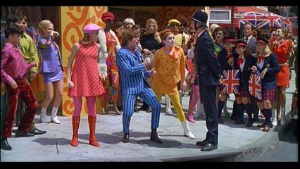

When you encode for a PC based format (like DivX) you'll have to first unqueeze the picture and then resize that to your desired resolution (this would correspond to a stream having a 1:1 DAR). Formats for standalone players like VCD and SVCD work differently, since they too have a DAR flag (4:3 or 16:9, where the latter won't work properly on all known players). So let's take a look at what has to be done here. The first step is to get the correct aspect ratio at the DVD resolution. In order to do that the picture has to be resized as can be seen below:
Compare this with the first and 2nd picture. You'll see that it has the same resolution as the first one but the same (correct) aspect ratio as the 2nd one. This process of taking a frame and resizing it to the DVD resolution while retaining the correct aspect ratio is called letterboxing. As you can see we use less of the available vertical resolution. This is ideal for 4:3 TVs since there the picture can be displayed as is, whereas when you have a 16:9 DVD the player will first have to perform this letterboxing transfer (which involves a slight, albeit unnoticable, quality loss). If you haven't properly set up your DVD player (4:3 TV = set the TV format to 4:3 or 4:3 letterboxed, 16:9 TV: set the TV format to 16:9) there will be no letterboxing and the picture will look squished as in the first screenshot.

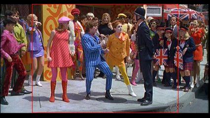

Let's have a look at our source frame again.
What is being done in a pan&scan transfer is that a part from the source frame, having an aspect ratio of 1:1.33 or 4:3 is being cut out. This is symbolized by the red square in the picture. This "window" is not fixed but flexible. So when the actor moves to the right border the window can follow him up to a certain extent. This is the pan part of pan&scan. In certain cases the window might also zoom in on the frame, hence the scan part.
As you can already see in the screenshot pan&scan transfers lose a lot of of the source picture and ruin the director's vision of how the movie should look like.
